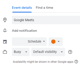

I was asked by a staff member today why they are unable to add a Google Meet through Google Calendar.  They are able to do it to their primary calendar, but this does not seem to be an option district wide on secondary calendars.  Is there a reason for this or a way to add in that ability?

I did find a work around while I waited, which was to go to meet.google.com and make a new meeting.  When you pick schedule in Google Calendar, you can then change it to be on the secondary calendar and it appears to work.  The last Google support tech told me that it's not possible to have the option to add conferencing on secondary calendars...  I've spent little time with Google support, but my impression so far is it's just time wasted.
