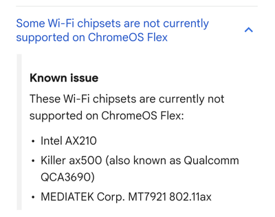

I'm afraid I haven't tried any as yet, but I am having problems with WiFi recognition on ChromeOS Flex. The PCs I have purchased (with built in WiFi) won't recognise the WiFi on ChromeOS. They are recognised using Windows 10.

pertuz
Ther s a list I found last night of incompatible (or incompatible for now) WiFi chipsets.   I was trying to test flex on my personal laptop and my work one and coincidentally both had issues
